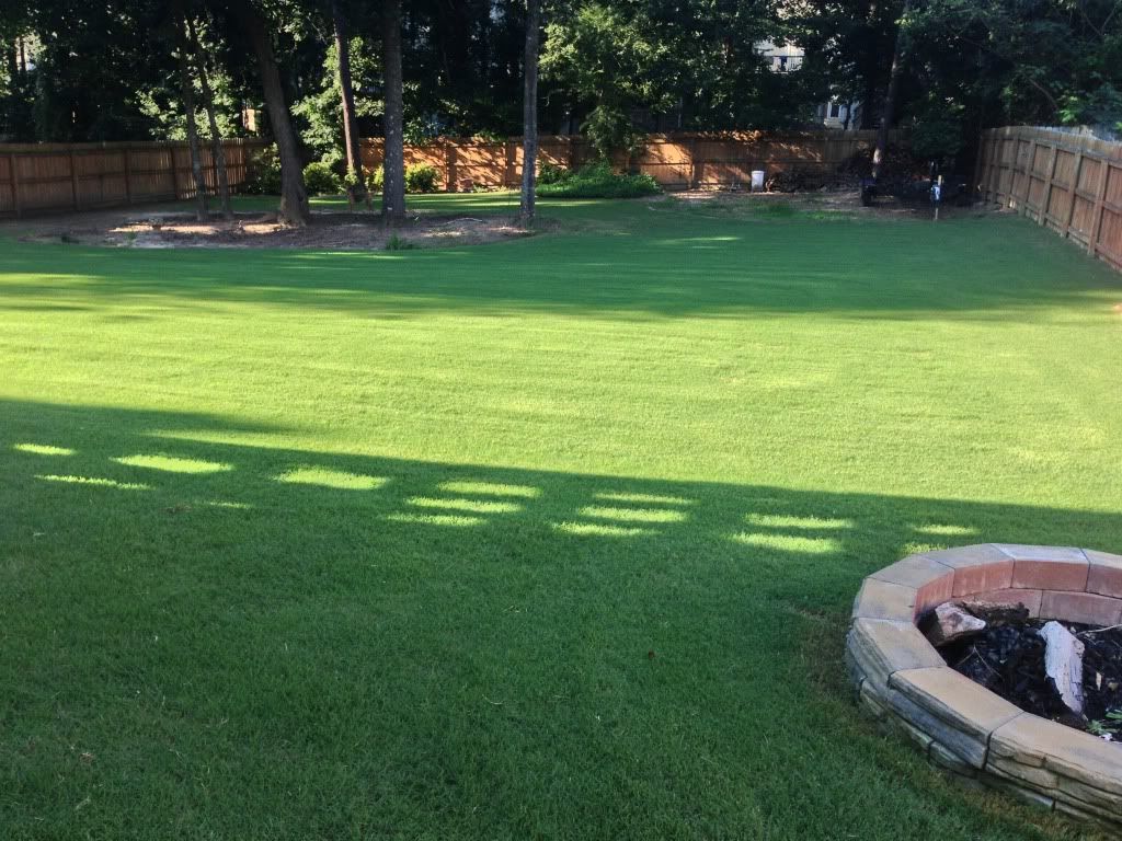

As the title states, I am having issues cutting evenly/level. About a month ago I started to notice it so I attempted to level the deck. I could never get it just right, but I got close (I thought), but it never worked. I noticed that the leveling points on either side of the deck were so close to the centerline that when I lowered one side too much (to match the opposite side) then the opposite side lowered, too.
I got so frustrated that I decided to look into my blades. They were the factory Craftsman mulching blades. They appeared dull, so I headed to Ace for a sharpening. While browsing around, I found the same blade new and held mine up against it...MINE WERE BENT!!!!! Problem solved. Bought a couple Gator 3-in-1 something or others (I believe) and headed home. I installed them and again had some difficulty leveling, but I got it very close. Made my cut and back to square one. It is very inconsistent, though. Some areas look perfect and some look like I mowed grooves into the lawn.
Any suggestions?

Turns out I focussed too much on leveling the deck left to right, I never checked the height front to back. I think the manual said there should be about a 1/8 inch difference between front and back and I had just over an inch.
All is well in my world again.
