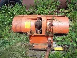

Well how crazy am I wanting to try this? Making it attach to a Cat 0 or Cat 1 3point should not be very much trouble. Converting the 540 PTO to run the tiller at the correct RPM and how to mount the PTO shaft is the trouble. I saw one person selling with the PTO shaft mounted Direct to the gear box (ariens, very similar tiller style), no belts.... Should I would I need a belt or a slip clutch? Any thoughts on the RPM's ?

I thought the 140 used a set of pulleys to drive the tiller, I've seen a double sheeve setup on them from the rear PTO shaft off of an electric clutch!

Looked like that shaft setup was too long, but I'm not sure how far in the PTO shaft on the 140 is. Some yellow paint will eliminate that PATIO problem!!! :ROF
TroyMN, what we're trying to tell you is that the tiller if it is original may be worth some money to a collector. John Deere ran a series of GT's in the 70's called "Patio" models which now are very rare.
17,111 Posts
The attachments were white for the Patios That tiller pictured up above is not a number 33tiller which would have been used on a 140 Here is what a Number 33 tiller looks like.

Wow Sergeant, that looks like it was sitting on the showroom floor! I thought all the powered rear attachments from the 140 used the double pulley setup. I'm just not as familiar with the Patio series since I've seen so few! I didn't realize that all the attachements were white! You learn something new here everyday!

The top picture of mine is just a Craigslist add that was converted to 3-pt/ PTO, I think it is an Ariens.

You know what - I am completely wrong. And i even have a 33 tiller 10 feet from where i am sitting now. Sergeant is correct as usual. All patio implements were white. Color threw me off, and i thought there was something in front of the tiller concealing the double pulleys.
Not sure what that is from. Maybe an ariens? Power King?
