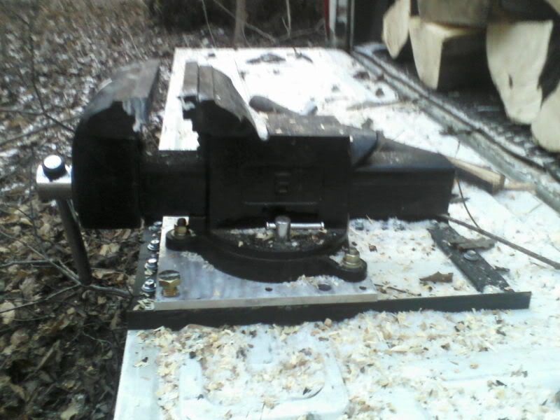

I use the Stihl file guide that clamps onto the file. I like how it sets the depth of the file on the tooth. I've found that was the hardest part about filing free hand.
I also found that a vise of some kind makes a world of difference in sharpening. A stump vise is small, relatively cheap, and does a pretty good job, but I decided to cheat and come up with a way to mount a bench vise to my truck. I didn't want to use something that mounted to the hitch because I didn't want to have to close the tail gate to use it, and it I didn't want the mount to be too big or heavy. Here's what I came up with for me.
The vise is mounted to an 8x8x3/8 alum plate using 3/8" flat heads that are counter sunk from the back side. I've found that once a flat head is tightened, they don't come loose :) Plus, it makes the back side of the plate flat so I can still mount the vise to my welding bench. The alum plate is bolted to the truck mount with 1/2 - 13 bolts. The nice thing about 1/2" bolts is that they have a 3/4" hex head which a 19mm scrench fits very well. I used a cut off wheel to cut a slot in the top of each head so that I could use the flat blade on the scrench to do most of the work. The mount bolts to the tail gate with self tapping sheet metal screws. In hind sight, I wish I would have welded it, but the screws have worked fine. The vise lives on my welding bench where it gets bolted down with all 4 of the half inch bolts, but quickly comes off and goes in the truck for a trip to the woods. In the truck I normally only use 2 bolts in opposite corners, and I tend to keep 3 or 4 of the bolts laying in my chainsaw tool box. They work as insurance. So long as I have them, I don't loose any :) Having a 6" bench vise to hold the bar is SO NICE when I'm out in the frozen woods trying to touch up a chain, or even doing field repairs on one of the saws, and mounted to the tail gate puts it at a great work height for me. The vise is especially useful if I happen to be using a bigger saw. Doesn't matter either way. Just chuck it in the vise, grab the correct file, and in 10 min, I'm fueled up, oiled up, sharp, and ready to go.
