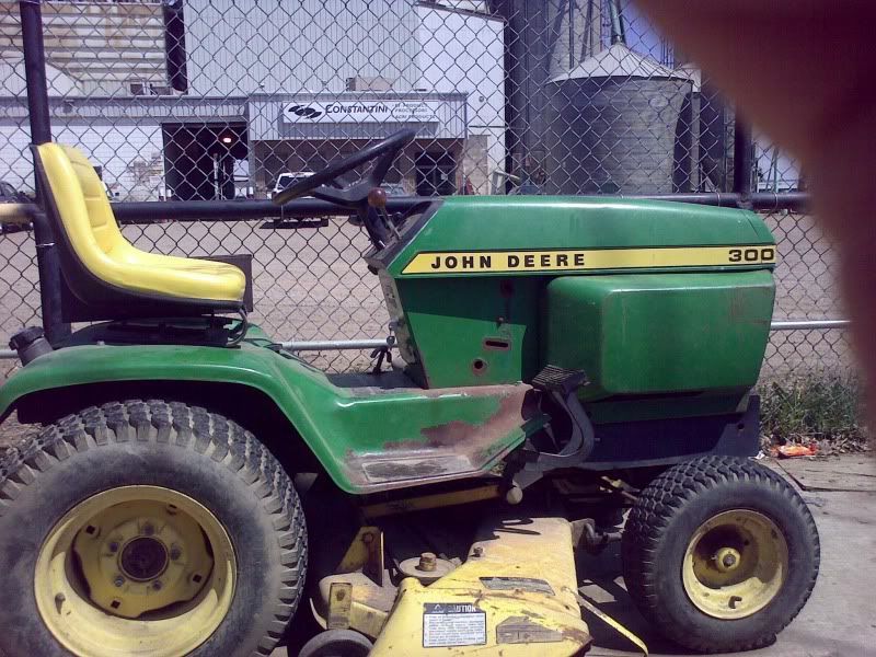

Can anyone give me the part number for blades for this 1977 John Deere 300 tractor? I am planning on buying it but I don't know what size this deck is and therefore am not sure which blades to order. The tractor model is C300F 070576M and the model number on the deck is 4048F 37381. I would be interested in regular blades and/or gator mulcing blades. Here is a picture of the tractor. Thanks.

I do believe that 4048F indicates it is a 48" deck. Run a tape measure from the inside left edge of the deck to the outside right end of the right blade.

I just went to JD web site, went into the parts cataloge and as nere as I can see for a 48" deck the part No would be M41967
