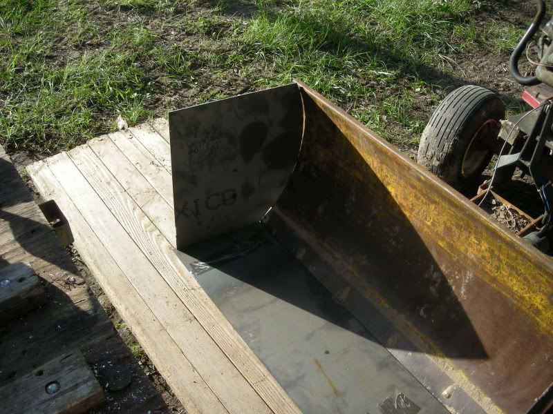

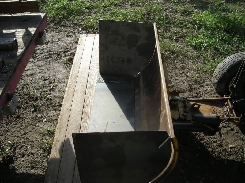

The Johnny Bucket gave me the idea, but that bucket is just that! A bucket and only a bucket. I think it would sell more if it was based on a plow and would have the versatility of both, a plow and a bucket. Not to mention that it's expensive and more $$ than I want to spend.
And I'm beginning to think that I have more of a need for a bucket than a front mounted plow, tho, the plow does come in handy at times. So far, it could almost pass for a box blade. I should be able to get some of it welded up tomorrow and see how I want to mount it. I know that .625" DOM with .125" wall will have something to do with it. Hmmmmm......

will it tilt back farther ? that is the only glitch that i see is that if it doesnt, it wont hold much material.
nice lookin build. if it were me id round those top edges. looks like that would hurt on the shin and maybe lay a guy wide open.

How will the dirt dump out?
465 Posts

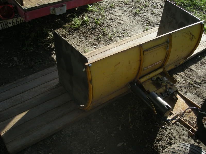

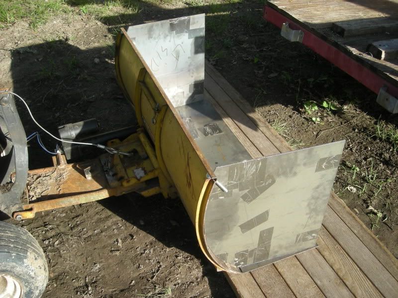

It'll tilt back further when I raise it, tho, I could reposition everything so that I could tilt it back without raising it, but, I would loose some on the "dump" side. As for all of those edges, the sides still need to be cut diagonally. I only cut the basic curve to fit them to the plow. Tomorrow is another day.
If you notice in the pics, there is an actuator attached to the plow. I've been playing with it for the last week or so, stacking dirt piles and dumping everything at the top and all I can say.......N-I-C-E!

Oh, now I see what you are attempting to do......earlier in the other thread you mentioned clam shell, which is why I thought it was going to be a clam shell. But the actuator will make a nice dump/curl for it and the cable will for sure lift the stuff up. I saw the angle of the picture with the log, and that should do a fair amount of lift, IMHO.
Just on suggestion......maybe you could figure a way to make the "bucket" become removable so when snow arrives you could do the plow blade thing and then when its dirt or gravel you are playing in, you could remount the bucket sides. Just a thought. I guess in MI, you would have a use for the bucket for snow removal as much as just the blade.
As of now, it will be removable, but, that could change. I don't know yet. I really don't want to lose the versatility of the plow unless the bucket can make up for it.
