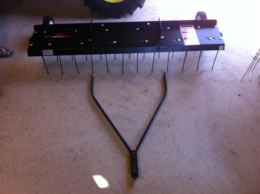

I recently ordered a Brinly-Hardy 48in dethatcher from Home Depot on-line; $99 with free shipping. It is designed to be a tow behind, but I really wanted a 3-point hitch dethatcher so I can back into some tight places in the yard, but they are way too expensive. So I put it all together, leaving off the tow bar parts:

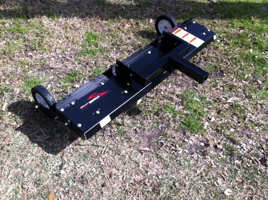

Then I fired up my little welder and cut-off saw, and built a receiver hitch mount with some square tubing and flat iron:

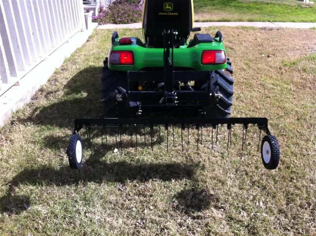

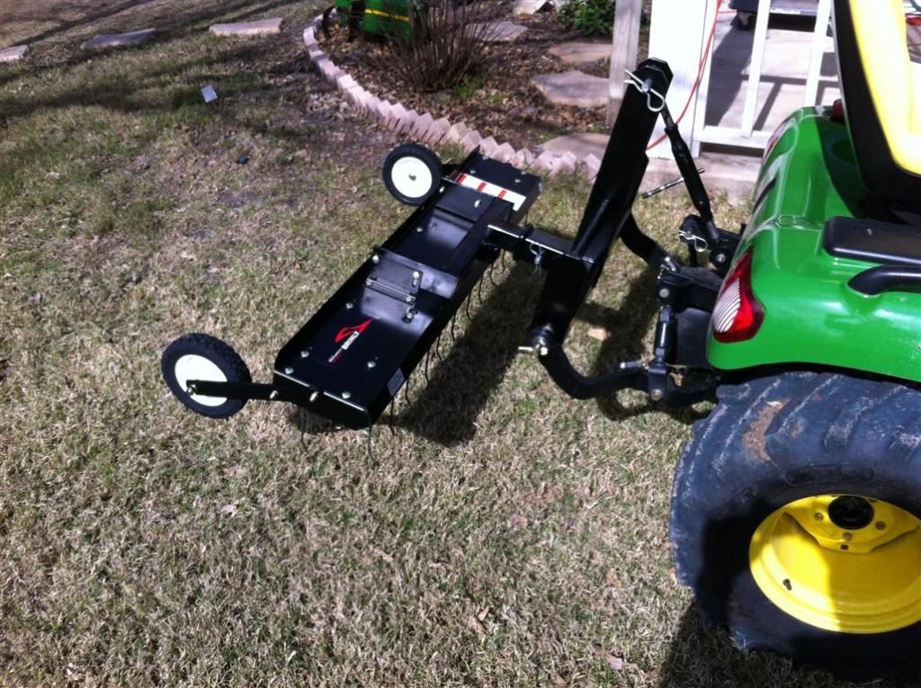

Once I got it all painted and put together, I mounted it to my heavy hitch and voilà ("wallah" if you live in the sticks) -- instant 3-point hitch dethatcher:
It really works great! :fing32:

I'm curious though; since you were doing the mod, why didn't you just make it a true 3pt mod and connect it directly to the 3pt hitch bypassing the bulk of the heavy hitch all together?
I plan to do just that with my Brinley dethatcher, aerator and other 'toys' come spring (stay tuned). I'm hoping to make them Quick Hitch compatible.
Because then I would have to take the HeavyHitch off of my tractor to dethatch. :fing32:
I used the HeavyHitch for so many things, and I am in and out of my FEL so often that the HH stays connected to the tractor except for the couple of times a year when I am tilling and bedding.

Weight is needed for the dethatcher, so the heavy hitch has an added benefit.
