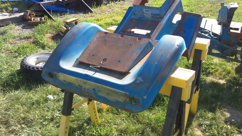

With the body off, I scuffed it up well with a sanding sponge, and removed the old stickers (except my foil tag, that's staying):
The paint actually looked much better once the rust staining was gone, but I was pretty committed by this point. After sanding, I washed it down with Simple Green. My steam cleaner didn't survive the winter (again) so unfortunately I had to hand wash it with cold water.

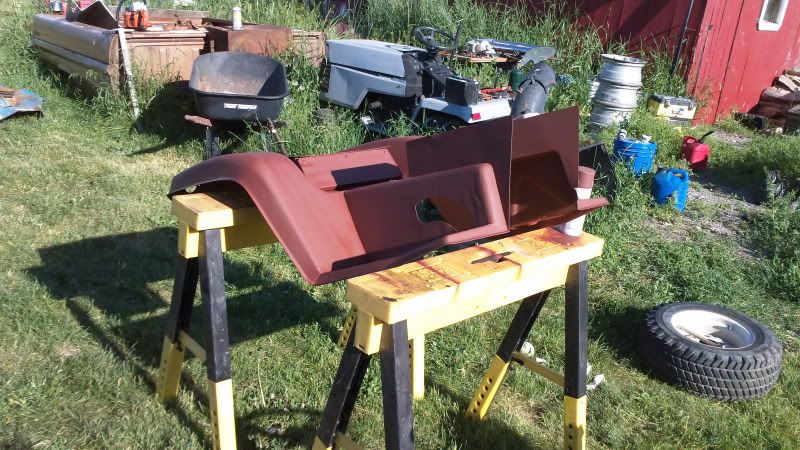

I primed the whole tub, painted the underside and used a high build primer on the top:
Tomorrow I'll wet sand the top with a scotch brite pad, and paint.

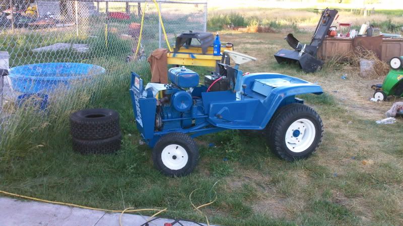

I primed and painted the rear half of the chassis as well:
Not a full restoration by any means, but it'll look decent for a while in addition to running well.

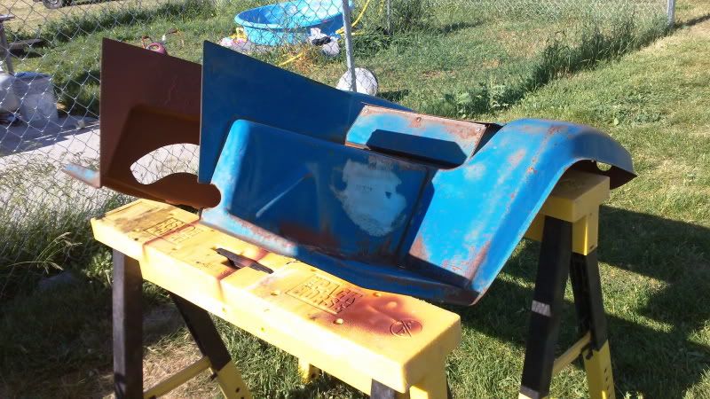

Rear body tub painted and wet sanded. I wanted to just do one coat, but the wind here made the overspray so bad I had to wet sand and do it again:
