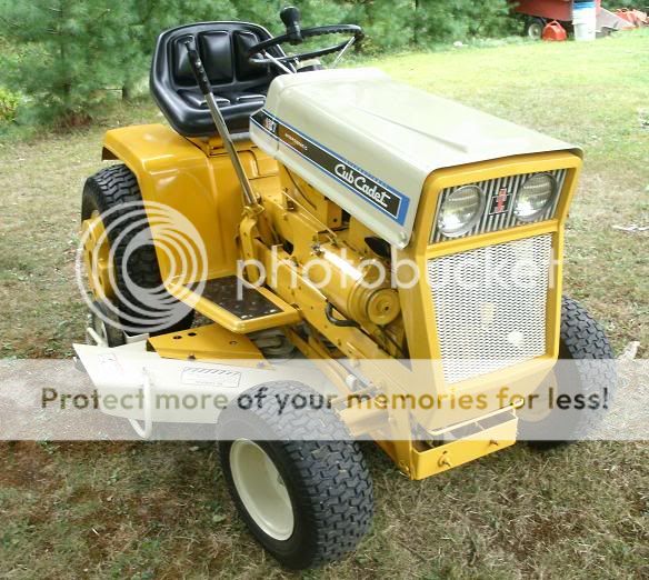

just got this cub cadet 127 yesterday. mowed my lawn with it today and noticed that the hydro lever is fairly loose and makes it hard to find a good speed. and also it accelerates on its own once in awhile when hitting bumps or going down hill. the actual lever moves when this happens. does anyone know what i can do to cure this?

If you look under your dash, between the console and the engine, there is a small collar that you can tighten up to put drag on the shaft that the hydro lever is attached to. Put just enough drag on it to hold it, not enough to make it difficult to move.
3,038 Posts
What Pete said I also had to do too. I think it's something like a 1 1/16th cut off open end wrench to slide down and tighten up the collar. You actually "pull" down on the F/R lever to tighten the tension.
46 Posts
Take out the battery and take your time to make a tool. Not so tight that it will not return to centered when you step on the brake,check that as you tighten. It should return to centered from both forward and reverse,or close to it. GSS-1404 is the service manual for that series,big section on the hydro and most anything else you might get into.
92 Posts
you should have at least 8lbs..manual says 10lbs i think..use a strain guage to measure..you can hold the nut with a smallish channel locks if you dont wanna make the tool...your 127 looks brand new..i could never find em in that shape...always cheapo junkers..good buy..after you adjust everything you will be happy for years

wow 8-10 pounds, it maybe has a few pounds right now, moves with no effort, ha it moves on its own now. im glad this is a common issue with a fairly easy fix. was hoping it was nothing too serious, that would have been a downer. and thanks for the comment on it, the guy did a nice job and i hope it lasts as long as it would if it was new.
