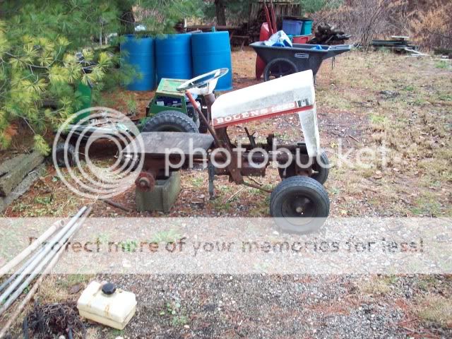

About 8 months ago I bought this tractor as a parts or project tractor and decided to make it a project. As I have been digging into it more I think it would have been better for parts lol. When I'm done with it I plan on giving it to my uncle since he likes to play on the tractors I have. I have slowly been working on and off on it since then and don't have much to show for it. I will updaqte this thread as I make progress
This is what it looked like when I got it.

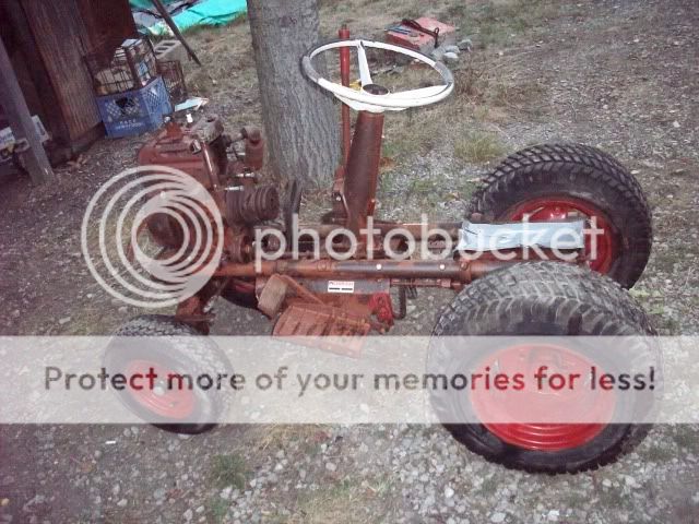

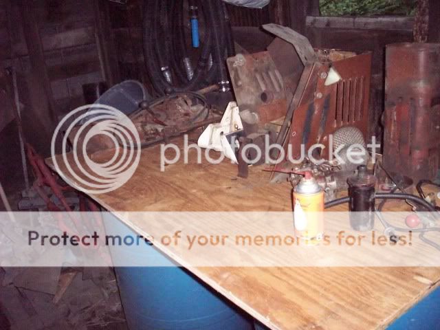

Intial teardown

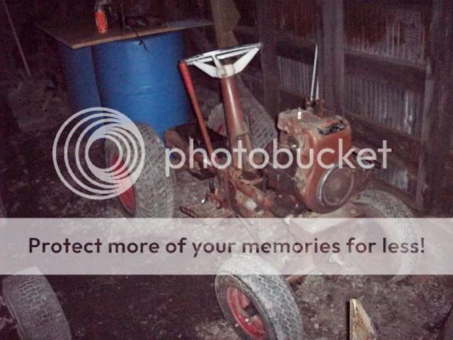

After pressure washing

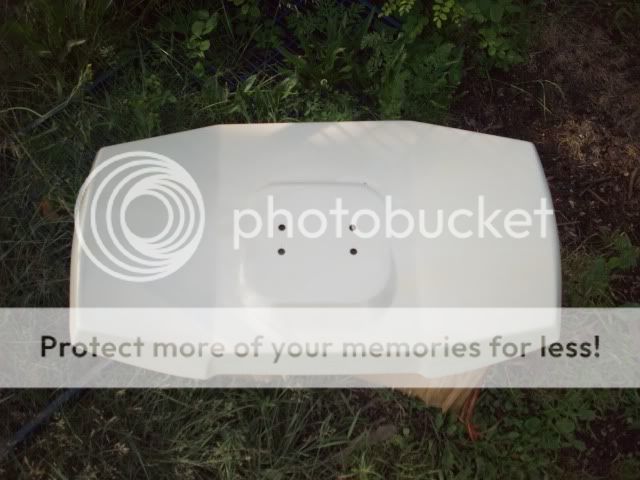

The fender pan done
Winter storage
