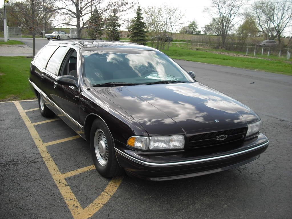

Hello! Being the Lawnboy freak that I am, I haven't wandered out of the Walk-Behind Mower forum much... but I see some interesting car conversations here.
Anyway, just wanted to share a few pictures of my project 1995 Caprice Wagon. It's a completely rust-free former soccer-mom car that I picked up a few years ago in Raleigh. I converted it to a T56 six-speed transmission, which makes it a real blast to drive! I posted some of these pictures in a conversation on the Walk-Behind forum, but I thought I'd stick some over here as well...
Below is a re-post showing the transformation:
Anyway, this conversion was a challenge. The first problem was getting a clutch pedal mounted. Below is a picture of a special adaptor that mates the Camaro/Firebird pedals to the caprice firewall, along with the installed pedals:
Then I had to select a console. I decided to find a second passenger seat and install it in the driver's position. Had to switch the recline switch over to the left side. Found a console from a 2000 Blazer, and stitched up a "corinthian leather" shift boot by hand. Came out okay:
Then of course there were a million details, like getting the ECM program right, eliminating the factory automatic shift lever (I used a steering column out of a '96 Impala SS, which was a floor-shift car), installing a thumb switch ignition on the column to make turning the key off by accident less likely. A switch from a Corvette worked perfectly. Oh, and then I had to remove the "PRNDL" display on the dash. Yeah, a bunch of details:
Anyway... a bunch of work. But I like the end result: The best car GM never built! :fing32:

It is a lot quicker. Part of that is because I needed to install 4.10 gears to make it work well with the 6-speed. :drunkie:
Still, even with 270 horsepower and 330 ft-lbs of torque, the car isn't what I'd call "fast" by any means. With 4,600 lbs to get moving, this car can use all the power it can get!

Yes, I stopped in breifly at a car show and there were some cool old cars there, that one just happened to be cruising in when I snapped the picture of my car. Those old Lincolns really were bizarre. Very cool cars, though.
