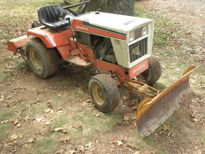

Ended up buying an angle grinder from Northern Tools, should have bought one a long while ago. Would have saved me many small expensive Dremel bits. I cut it up, sanded down what I could, positioned it, and took it to a local welder guy. He did a nice, clean job.
For the lift I used a three foot 3/8" stainless steel cable from Home Depot. I know it came with a sort of push rod with a spring relief, but I can't imagine it added all that much down pressure. The wire seems to work fine, I looped both ends and attached it with bolts.
Here's some shots of it. I painted it with the Chevy Engine Block Orange-Red spraypaint from Advance Auto, once it gets a layer of dirt on it I think it'll look fine. I redid the cover plates on my mower deck with the same color and it looks great
You are going to want to put the spring system symplicity had. First time you hit something that rod is goin to bend...
He is using 3/8 cable
The factory lifting rod with the springs will put enough down pressure to allow the blade to dig some, with out it like you have it, the blade will just ride over everything.
I would keep looking for a correct blade that will fit the 7116.
Ahhh, I thought it was a rod... Makes more sense.
Yeah, 3/8" cable. Zero down pressure, but the blade is heavy enough that it pushes what I've tried pretty well. If it hits a rock it just bounces up.
I did space the lift arm on the bracket so that it's the equivalent 15" from the tractor (thanks for the diagram arathol) so I should beable to use a standard Simplicity push rod if I can find one.
