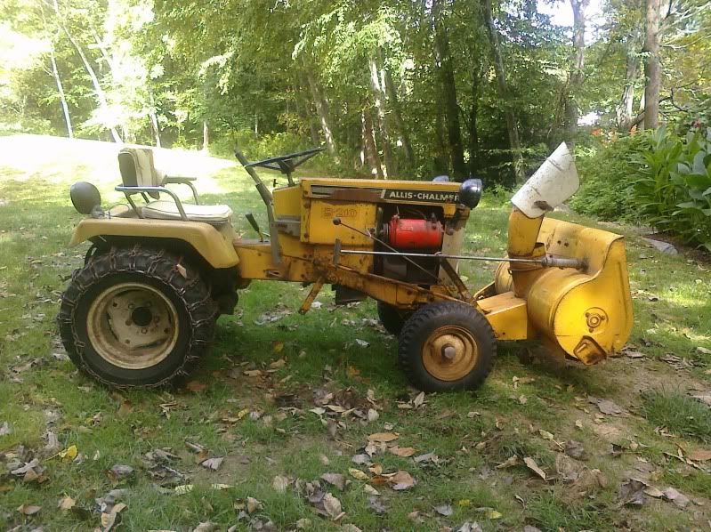

I brought home my Allis Chalmers B-210 today. I picked it up for $450 with a 42" mower, 36" snowblower, wheel weights, and tire chains. I'm not planning on a restoration, but I do want to fix it up a bit. I'm going to start with figuring out why the lights don't work, then try to adjust to Vari-shift, and inspect/clean/change fluids on the rest of the tractor. I bought it to haul a cart for firewood, and the snowblower is a big bonus, because I won't have to use my walk behind blower to clear a path for the tractor. It may replace my walk behind snowblower for driveway use also depending on how well it works. I will also be pulling an aerator and dethatcher. This is my first old garden tractor, so it will be a learning experience. I'm sure I will be posting up with questions soon.

Okay, I have my first question. While check on the headlights not working, I have found that the voltage on the A and F terminals of the starter/generator to be 4V. Using the troubleshooting guide that I found here I grounded out the F terminal, and the voltage on the A terminal went up to 17V. It states that this indicates "the regulator cut-out section is probably not connecting the A terminal to the battery". Can someone please explain this further?
1,445 Posts
it is likely the points in the regulator on the generator coil that control the flow of current thourgh the system are burnt or a wire is broken. What does your ammeter say? You could ground out the F terminal and it would charge but it would shortly boil the battery and/or burn up the generator.
39 Posts
The ammeter is at 0 when it is running. When I grounded out the F terminal the A terminal voltage went up to around 17V., and the regulator started smoking a little.

Letting the smoke out of the wires is never a good thing….can you take the regulator apart and inspect the insides?
You have proven the generator is good. The problem lies in the regulator itself, or the wiring. I'd first check to make sure all of the grounds are good, especially the regulator's ground.

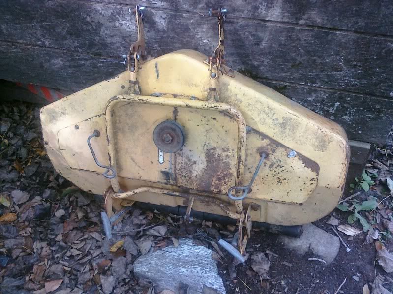

I brought the Landlord home for $100. It runs good, just needs a hood and some belts. It will really be a shame to part this out, but that's what I bought it for.
333 Posts
That tractor is a '64 landlord if it has the original engine it would be Briggs model 23, 9hp engine... I myself would not part it out, looks to be a good solid unit with the original bolt together deck as Phil pointed out.
