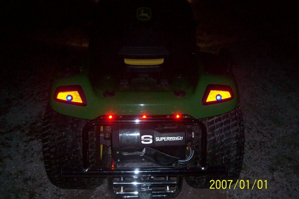

I put all blue led's under the machine and in the headlights! I added the bluedots to the tail lights and the rear light bar to give some additional backup lighting. The halogens mounted by the bumper are very bright for night time use! For winter I mounted large chrome bullet's right on top of the blower. I found that the lights on the machine reflecting off the blower more of a hinderence!
That is one unique look! I had never thought about the light bar in the back. Maybe I could find one that has a strobe mode for driving near the road at night.
