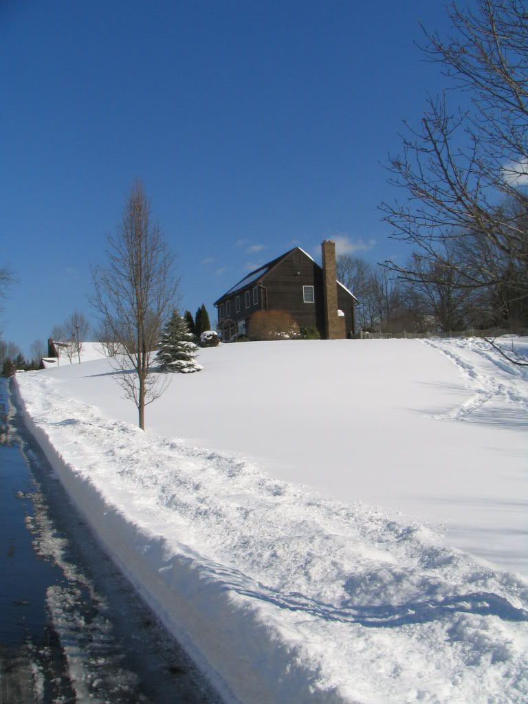

I use turf tires on my drive with no chains. Here is a pic of my hill:

1. Would people recommend R4 or turf tires for snow on a steep paved hill? The Kubota dealer says turf, the MF says R4. The turf tires seem pretty aggressive. The Kubota dealer said the R4's can slide sideways easier in the snow because there isn't much tread to give resistance side to side.
My experience and most of what I've read is that the turf's are actually best for snow. Don't have a snowblower, but I've used my BX with turfs and 4WD to clear snow with the FEL. No traction issues whatsoever. Don't think I spun a wheel once last winter.

I have a BX1500 and on my hill which is steep it moves a lot of snow each year and it has turf tires on it. It will not push uphill but will easily drive up in 4wd Low and push down or side to side. Also it will usually hold going up or down without brakes, but be sure to be in 4wd low as was stated earlier, still I have to use the brake once in a while. Here is a pic of me mowing across the hill. Good luck with the looking and purchase as volfandt said all the machines mentioned are fine machines. I am amazed what this little tractor can do and can't imagine what can be done with the one you are looking at! Take care-TPS
