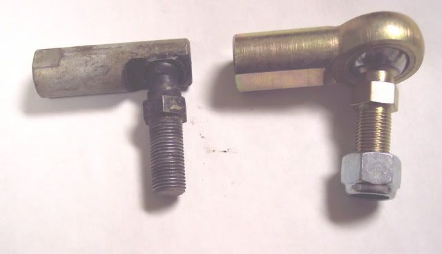

Well my 990 Steering Ball Joint finally failed and now its time for the upgrade. I replaced the old style with new Rod Ends (Ball Joint Linkage) and I can see a Big inprovement in my steering.

It needs to be updated. I did mine a long time ago. I increased the rod to 5/8 dia. also. I changed it to add my loader.

Part #s and sources would be greatly appreciated. Thanks again. Nice jobs!
:ditto:
I found the same as Blacksmith. Its a Studded Tie Rod 1/2-20 Female. The supplier was Fastenal. They do have a website and look under motor linkages.

Been there, done that. This is the upgrade I did on the frontend of my 990. Hasn't failed yet and I work mine. It also steers very easy. The upgrade I haven't did is the beefier tie rod. That is going to be done shorty because the tie rods are loose. There has been a discussion on my build thread.
