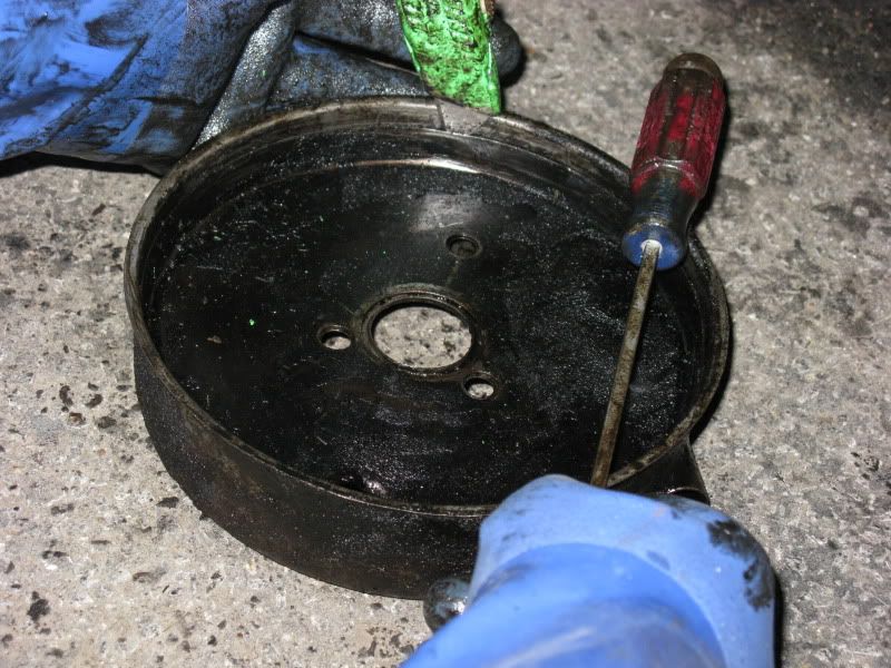

I fixed the 8453 last night. The muffler was clogged with carbon. I used a razor knife and plastic handled screw driver to separate the 2 pieces. I cut the 3 pinch welds with a screw driver. It was an arduous process but I was determined to properly clean it out. Besides I have a spare. I didn't take any more pictures because it was bedtime from my tool disorganiz....err..15 month old.
Once I had it apart I straightened everything with 2 blocks and a hammer. It took a few minutes to get it right again but it runs good now.
