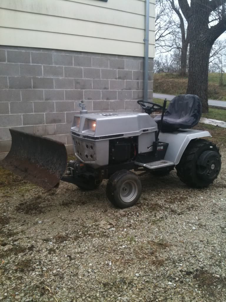

Slick tractor you got there! I've got the same model(not quite as clean) its been a real workhorse for me. Good Luck with yours and if you figure out how to post pics please share. I'd like to see more.
And my GTV-11 is very, very similar, except for the engine, Varidrive, and, tranny. My deck is almost a twin to yours.
