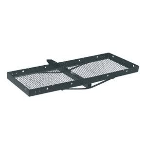

I also own a 60" wide 20" long hitch rack like this one, only down side is the "hitch weight" it would add

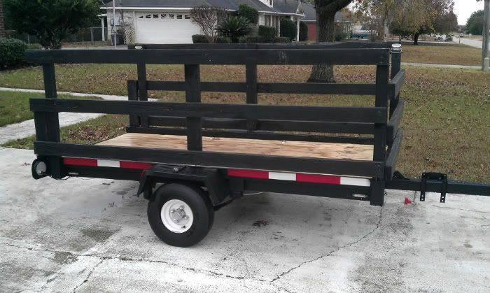

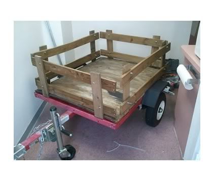

I was thinking about buying a trailer like this one, they are about 100lbs and have the 40 x 48 bed. Would haul all my stuff and most of the weight would be on the trailer axle. Down side, is its another tag, tires, bearings to take care of, and I would feel the need to paint it to match and dress it up a little so it looks a little better behind the car. Here is a pic of how I would like to set it up

40" x 48" trailer, Cost $230 normaly, always get the 20% off coupons and plus it goes on sale alot, tag $20 a year. Paint to match car and wood prob another $70-$100

I'd go for the little 40x48 trailer, but look for one with 12" wheels.
Hitch racks are OK but as low as that one is going to be behind the Camaro I would imagine it would be rubbing on the ground going into and out of driveways, etc.

Trailer. They're more sturdy than they look.
Yes, they're DOT approved.
Painted to match, it'll look fine. Maybe consider making it enclosed somehow instead of open with side rails.

Yea my thoughts were that trailer too, I did build a rise for the rack so it sits 5 inchs higher than the hitch, but yea its a lot of weight back there
Idk about the 12" wheels makes the trailer taller and would prob nose dive hooked up to the car. I been pulling my 4 x 8 thousands of miles at 75 with 8" wheels never any problems, but it has the bigger 8" tires and they are a 8 ply .... That little one would be the small 8" with a 4 ply ...... So maybe the 12" would be better with light duty tires

I've put a bunch of heavily loaded miles on a utility trailer with 5.70x8 tires, too, but given the choice I would have gone with 12" wheels. The bearings last longer and the tires will roll over bumps and holes in the road much better than the little 4.80x8 tires most of the mini trailers come with would.
As to the tongue height, just make sure your receiver ball hitch has enough rise to meet the tongue level or just slightly below level. They sell them with all different amounts of rise or drop - simply flip it upside down to raise the ball.
The trailer will track behind the car better with the tongue slightly low than it will with it high.
If you had the inclination to do some modification, you could extend the tongue which would also make it tow a little better. It would make backing up a lot easier, too.

I got the tallest rise you can get for a 1 1/4 right now and its still not real high but I do think it would work pretty well with the 12" wheels.
I like the idea of maing the tongue longer, that would help ALOT on that little trailer, maybe a small tool box on it too. :thanku:
