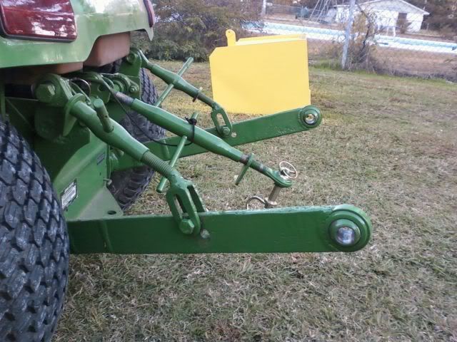

I take it you were able to build one? But no build Thread? Looks as tho you did a good job on it!:fing32:
That is a home made three point on a deutz-allis AKA simplicity sunstar. The 335 is a JD that belongs to a friend.

The Quick way with No Fabricating at all Of coarse it would Be expensive Because first You Need to buy a Hayes Multi Hitch http://hayes-ent.com/hitch/MultiHitch.htm Then You would Need to Buy a Kolpin electric Lift 3point Hitch http://www.kolpinpowersports.com/products/dirtworks-series/3-point-hitch-system.html?vmcchk=1 Only Nice thing about this way compared to the One Pictured In the thread sonny found You Remove the Kolpin with One Pin and a electrical connector and the rocker shaft Is Not permanently On the Tractor another Quick way which would only require Tapping into the Hydraulic system is Find a 3point Hitch for a 140,300,312,314, 316 Kohler or a 317 Which Might also require a Hole drilled in the 3point Mounting Plate for Your Hydrostatic Release lever. Just a Idea Because The Hydraulic cylinder is Part or the 3point when You remove It with The release of Two Spring pins and Releasing the Hydraulic Lines:thThumbsU
