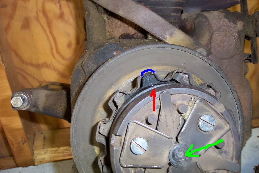

Thta's a mechanical PTO, correct? If so, you will need a good quality 1/8" allen wrench.
Here's the mechanical PTO that was on my K-301 in my 125
You will have to line up the hole with the set screws ( RED arrow ) with the cutouts ( BLUE outline ) to use the allen (hex ) wrench to remove them.
If you already have the engine out, simply bump the center button ( GREEN arrow) with a hammer while you turn it by hand to line up the hole and cut out.
I would clean out hose holes as well as possible. PB Blaster, KROIL, compressed air, something to get them clean. Put the allen wrench in and make sure it goes down in the set screw. Then loosen it ( " righty tighty --lefty loosy" ) . Remove that set screw.
There is ANOTHER set screw underneath. Yes, two in each hole. Remove the other one. Repeat for the other two holes.
Now gently tap while working your way around to get it off the bearing it rides on. There will three anti rattle clips on the friction plate to catch too.

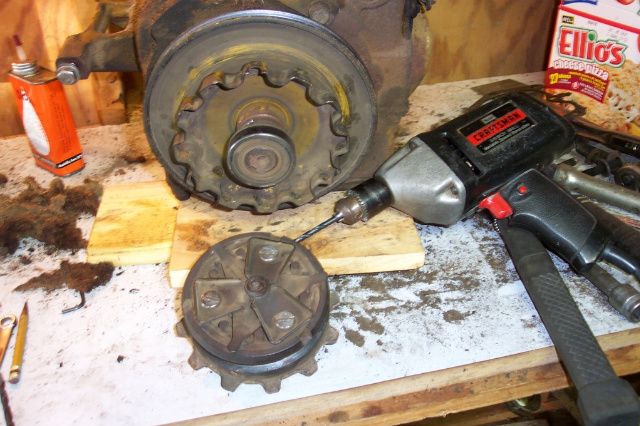

If bad things happen and you strip out the hex in the set screw, you will have to drill them out.
First, use a "f" drill ( .2570 ) to make a perfectly centered spot in the set screw. Only use that drill bit size to center your starting spot. Then use a 3/16" ( .1875 ) drill and drill slow (RPM ) since the set screws are hard. Make sure you are drilling straight. Once you get thru, open up that hole ( if needed ) with a 13/64 ( .2031 ) drill and then clean the threads with a 1/4-20 NC tap AFTER it's off.
