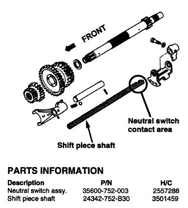

2. A Service Bulletin was issued back in March, 1996 for a "no shift" issue with the main transmission. Affected tractors were serial numbers 2000001-2500021. The shift piece shaft could damage the neutral switch, causing the interlock system to prohibit shifting. Updated shift piece shafts got improved surface treatments to prevent this problem. Fix is to replace the shift piece shaft and damaged neutral switch:
I appreciate your post and info. My Frame Number is TZAC-3500567 and the Engine Number is 1015981 so it looks to me like I'm not in the Service Bulletin.
