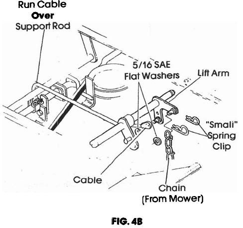

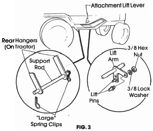

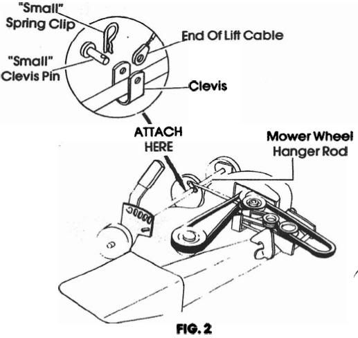

Finally gotten around to maounting the deck to the underside of the tractor. Because I haven't had the time or weather yet to take the Ford deck outside to work on (everyone who responded to my sandblasting request ad turned out to be flakes) I'm settled for the stock OEM deck for the time being.
The previous owner said something about the mounting something-or-other being missing, but infact it's all there. He was simply mounting it the wrong way. Had I actually tried ahead of time I might've figured it out, but regardless I got the proper manual on CD-rom for this deck off eBay. Mounting is a piece of cake.
Two pins mount a lift bracket to the front hangers which are integrated into the front axle assembly so that the angle of the deck follows whatever terrain the front wheels follow. A chain hooks the front to the lift lever, and an aircraft cable connects the rear to the lift lever.
The original aircraft cable would've been an assembled part of X length. I still have to create this cable from scratch and then adjust the engagement tension on the belt.
here are a few pics from the manual
[/QUOTE]
I had originall thought those 3/8" lift pins were missing. But when I came home with bolts to modify, I found out they were there. I also originally though the front mount pins were missing, and figured out they were there when I came home with bolts. So the only thing missing is the aircraft cable.
The deck, as far as I can tell now, just BARELY fits through the door of the shed when it's mounted to the tractor. I have about 1/2-3/4" I can trim off the jam if I need to, and still be completely closed when the doors are closed. Once it's on and all the proper tensiones etc are set, I'll take it outside and learn whether the deck will get hung up when I dgo down the ramp to the shed.
