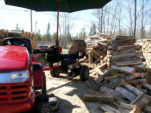

I am happy with my 20 ton MTD with Briggs engine that I use to split about 12 cord a year. Here are some pics I posted.

Two schools of thought on this. I like to park close to the rounds and toss the splits over to where I will be piling or stacking them. Rounds being heavier, I don't want to have to carry far and splits are light enough to toss. My neighbor doesn't toss his splits but he has to carry his rounds farther.

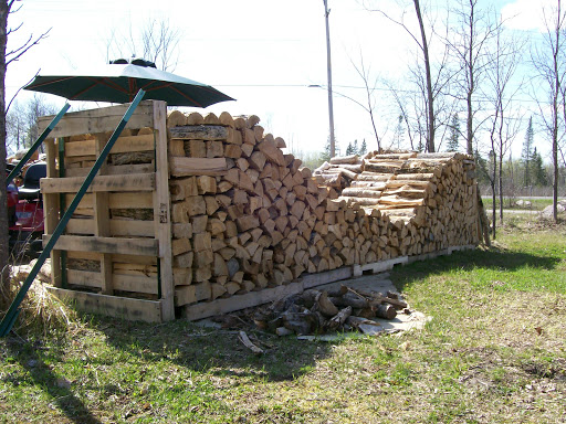

I hope you're not being facetious and commenting on the above pic cuz that ramshackle stack next to the splitter gets restacked. Here are a couple more pics.
This is the start of a temporary stack that will over-Winter where it is as it won't all fit in the shed.

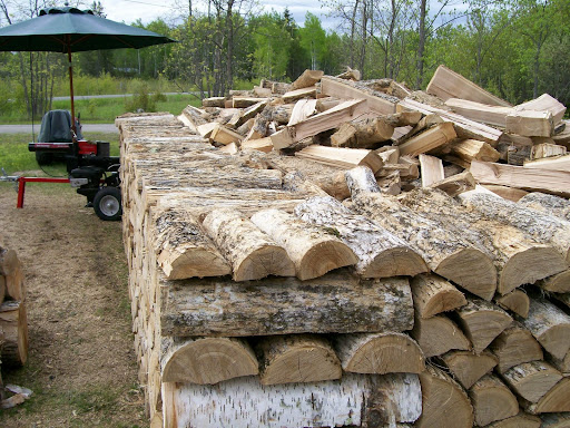

This is another temporary pile that will over-Summer here and eventaully be moved to the shed.

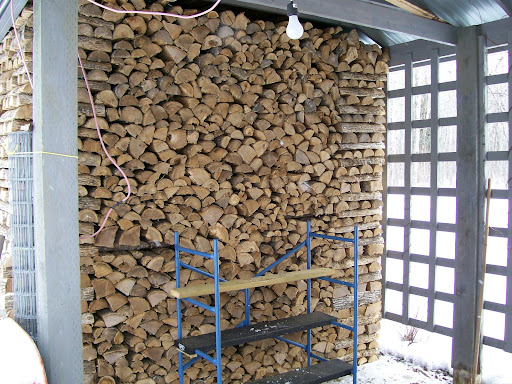

This is the last stage in the shed. Note that it is stacked 9 feet high onto a concrete slab.
