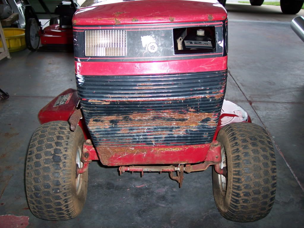

Well...here goes, this is how it looked when I bought it three or four weeks ago for $70. It had been sitting a "couple of years", covered I believe. I bought it from a man in Ellenboro, NC that worked on mowers, mostly Deere John's I think from the look of his shop.
I have my work cut out for me on the hood. I think it was used as a battering ram.

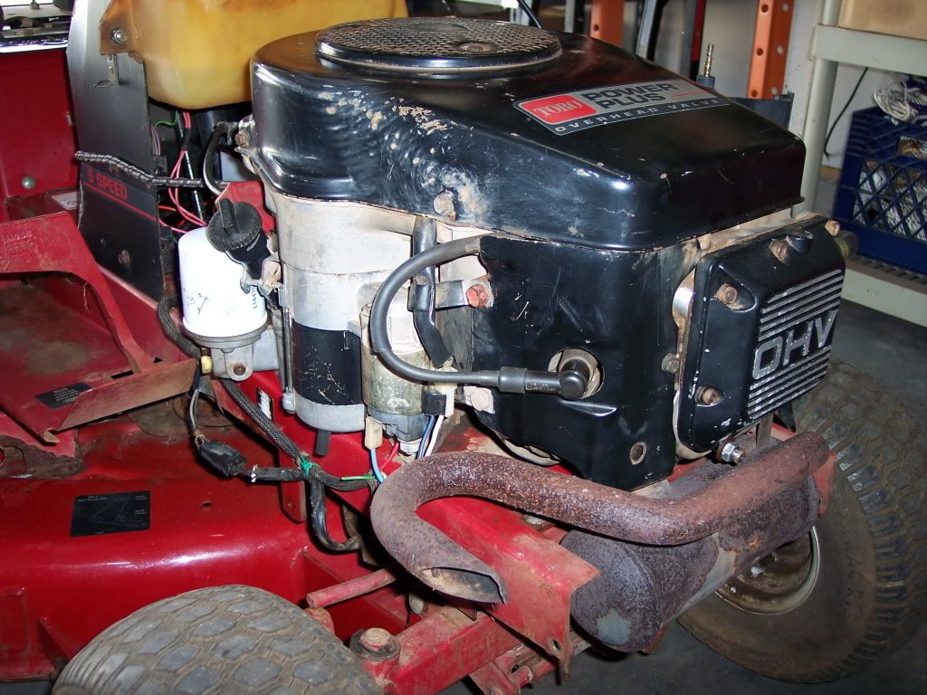

It was a little rusty but, no rust thru. I evaluated the engine and transaxle operation before I made a decision to restore it. The engine ran really good after a carburetor cleaning, just a hint of blue smoke on start up. the transaxle operated fine but I later found a loose axle on disassembly, I was not deterred.

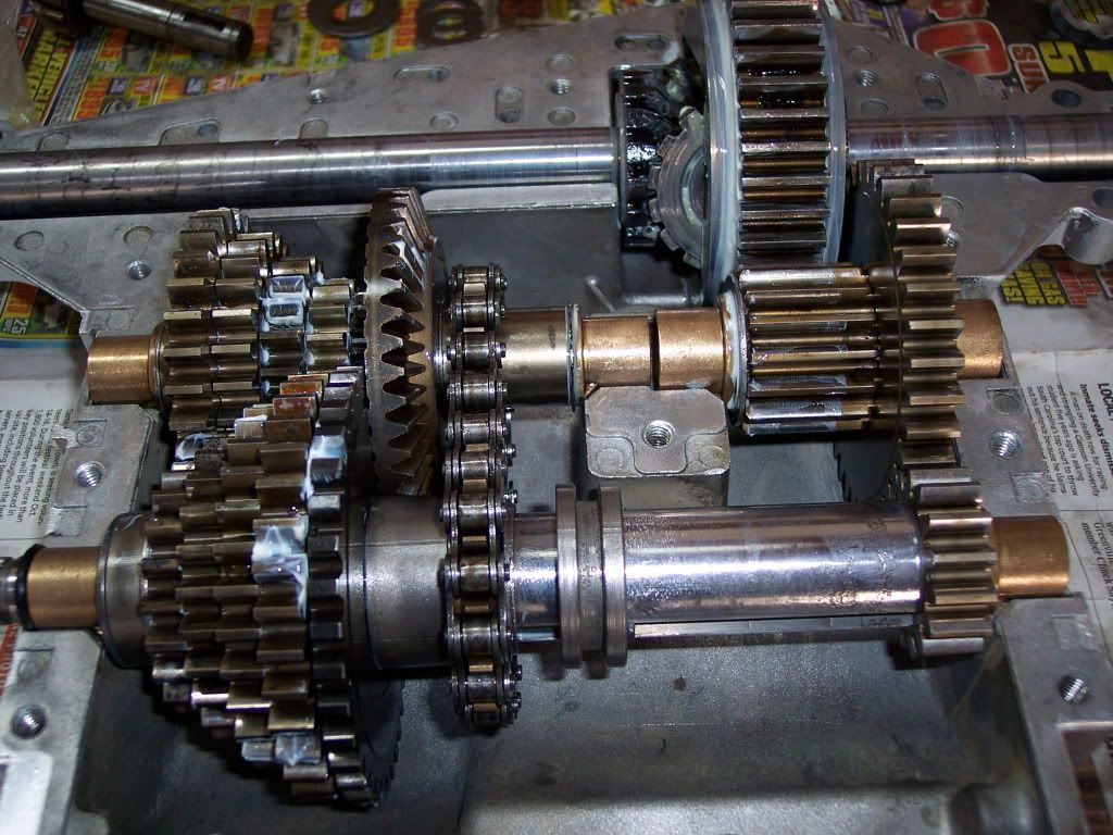

The axle is fixed with bearings. I sealed the case with Threebond, the same stuff I sealed my motorcycle case with. It works great and no leaks. I filled it with 80W-90 gear lube and turned it upside down, nary a drip. What about the shifter shaft you asked? I added an O-ring on top beneath the shfter arm. I filled the transaxle a little less than half way up, the gears with distribute it.

Neat to see the trans apart. I've had others apart, but not one of these. Amazing to see actual ball bearings, and bronze bushings. All I've ever seen are shafts running in aluminum bores. What a quality built transmission.
